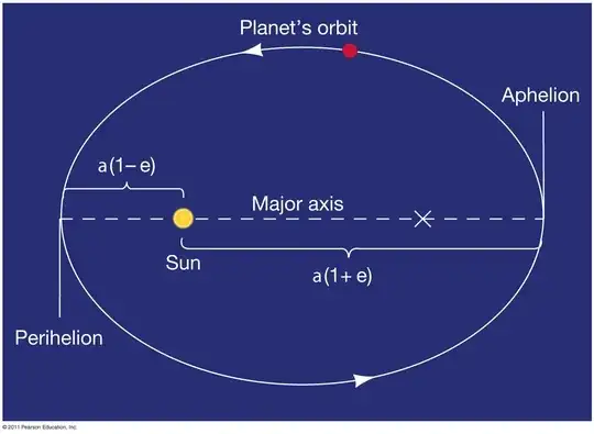

Due to the force of gravity, which goes as the inverse of the square, planets trace out an ellipse in space as they orbit around the sun, which is located at a single focus. The other focus is unphysical.
Actually, given two massive bodies, their "difference" vector will trace out an ellipse with the center of mass at the focus. Because the sun is so much more massive than most of the planets, we can usually disregard this since the center of mass is located within the sun itself.
Without going into more complicated effects such as orbit precession, here is an image depicting a planet's motion about an approximately stationary sun:
