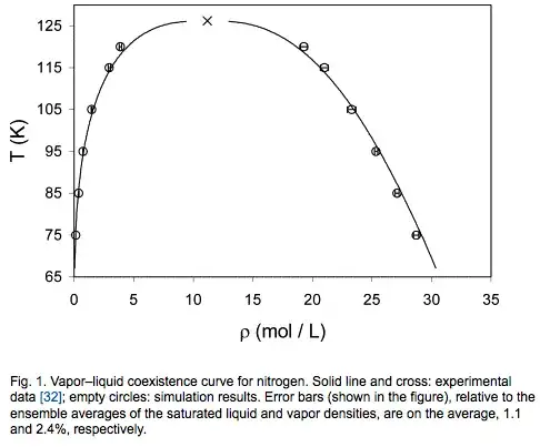

Javier Carrero-Mantilla and Mario Llano-Restrepo, Fluid Phase Equilibria, Volume 208, Issues 1-2, 15 June 2003, Pages 155-169 writes on simulation of liquid Nitrogen and binary mixtures with some other simple liquids. I've attached a figure from the paper which shows the liquid-vapor coexistence curve as a function of density, from which you could read off boiling point if you wanted. The agreement is pretty amazing, and they do use the strategy I outlined above - simulate Nitrogen as a classical fluid with a tuned intermolecular potential; their source for the potential is apparently C.S. Murthy, K. Singer, M.L. Klein and I.R. McDonald, Mol. Phys. 41 (1980), pp. 1387–1399..
alt text
I could dig around more for newer references, but if you're really interested, you can use google scholar and some of the search terms like "ab initio", "liquid-vapor coexistence", "Liquid nitrogen", "molecular dynamics" to find more...
