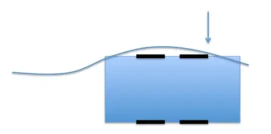

The sound occurs when wind is blown across a lip:
At the arrow, the wind is blowing like the air that a flutist blows across the mouthpiece - so it sets up a resonance.
Now for a resonance to work, the cavity must have a sufficiently high "Q" - quality factor. The air must reflect from most surfaces, and only have a limited chance to escape, right where the blowing wind is acting. If the hole in the window is too big, the velocity of the air escaping is too small to significantly affect the direction of the wind blowing over the edge, and so it does not build up the resonance. Thus, the window must be open "just enough" to provide the energy to set up the resonance, but not so much that the Q of the car goes down. I described this in more detail in an earlier answer about whistles - that might be helpful background.
