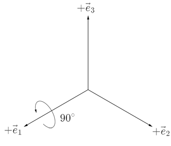

I was not completely sure if I understood the notation of the answer of David Hammen, so I performed a simple test. The test involves applying two rotations. Initially the two reference frames are lined up, where x, y and z axes in the figures for the inertial reference frame always point to the left, right and up respectively, while for the rotating reference frame the x, y and z axes are represented by $\vec{e}_1$, $\vec{e}_2$ and $\vec{e}_3$ respectively. The first rotation is 90° around the x axis:
Because in both reference frames the rotation is around the x axis, thus the rotation matrices of this rotation are,
$$ R_{I:0\to 1} = R_{R:0\to 1} = \begin{bmatrix} 1 & 0 & 0 \\ 0 & 0 & -1\\ 0 & 1 & 0 \end{bmatrix}, $$
where the subscripts $I$ and $R$ stand for the inertial and rotational reference frames respectively.

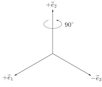

The next rotation is 90° around the z axis or $\vec{e}_2$:
The two reference frames now differ, thus the rotation matrices of this rotation are,
$$ \begin{array}{rrrrrr} R_{I:1\to 2} = \begin{bmatrix} 0 & -1 & 0 \\ 1 & 0 & 0 \\ 0 & 0 & 1 \end{bmatrix} & & & & & R_{R:1\to 2} = \begin{bmatrix} 0 & 0 & 1 \\ 0 & 1 & 0 \\ -1 & 0 & 0 \end{bmatrix} \end{array}. $$

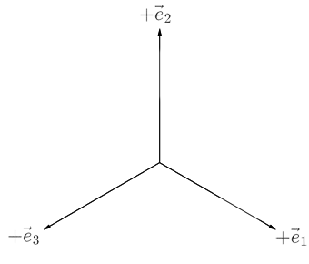

The final orientation should look like this:
The corresponding total rotation matrix is,
$$ R_{0\to 2} = \begin{bmatrix} 0 & 0 & 1 \\ 1 & 0 & 0 \\ 0 & 1 & 0 \end{bmatrix}. $$
When combining the two rotations in both reference frames, then the total rotation matrix can be obtained with the following order of multiplications,
$$ R_{0\to 2} = R_{R:0\to 1} R_{R:1\to 2} = R_{I:1\to 2} R_{I:0\to 1}, $$
thus it appears that the following is true,
$$ R_{n+1} = R_n D_R = D_I R_n. $$
