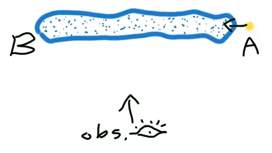

Let's say we have a cloud of dust which is a lightyear across and someone shoots a beam of light from point A to B , why it is not possible for an observer far far away to see the light while it travels through the cloud at the speed of light?

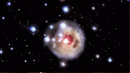

Sometimes we do, and the phenomenon is called a light echo.
What you're looking at there is NOT moving gas. It's an "echo" exactly as you describe.

All these conditions were met by the link which NeuroFuzzy provided, which appears to be time lapse photography of a pulse of light from V838 Monocerotis echoing off of a dust could behind it, the most spectacular light echo in the history of astronomy, according to the European Space Agency.
It is much brighter than even a supernova, but it is not exactly an explosion. The light from the initial pulse reached the earth in 2002. V838 Monocerotis didn't lose its outer skin. Instead, it expanded enormously in size, until its outer skin was not much hotter than a light bulb. This is very unusual behavior and may have been caused by one star cannibalizing another.
The animation of the light echo does NOT depict ejected debris. What you see is the light itself reflecting off of interstellar dust that is mostly behind the progenitor, not in front of it. The light echo forms an expanding ellipsoid with V838 Monocerotis at one focus and we observers at the other. It's concave toward us. A good description is in the Wikipedia article, which is the last link below.
Here is an account of the event, and an even better time lapse video, thanks to the Hubble telescope: http://www.theatlantic.com/technology/archive/2014/06/space-cannibalism-is-beautiful/373260/. It's fascinating to see the progress of photons themselves as they cover vast distances.

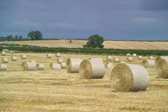

If some of the light is reflected off the dust at such an angle that it is diverted to reach the observer, the observer will see that light. However, those specific photons reaching the observer will not reach B (unless they are reflected there by the observer). Similarly, unless the observer is at point B (which is not the case in the question as asked), or light is reflected from B to the observer, the light which reaches B will not reach the observer.
The observer may use past experience about the behavior of light etc. to infer that the source of the light is not the dust particles but A, and that any light not dissipated by dust will reach B. For example, in the following image, we can infer that the source of the light is the sun and that some of the light, not dissipated by particles in the air, will likely reach particular spots on the ground in that field. Here, we can also see that some of the light reaching those points on the ground is reflected back to the observer, confirming the inference.
shafts of sunlight over field poking through clouds
The observer, illustrated as an eye, is a light detector which only detects light reaching it, the observer, not light which doesn't reach it. (That's the short answer to the question.) The observer will also have to wait whatever time is necessary for the photons to go from A to whatever it's being reflected off of, to the observer.

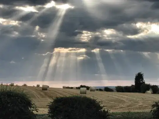

By contrast, in this second photo, certain frequencies of light are reflected from B (points on the ground) to the observer, but the path the light is following is not as clearly shown because of the differing amount of particles on the path between those ground-points and the light source.

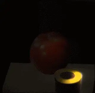

Using a camera that can capture "Motion at a Trillion Frames Per Second", this can be done at the laboratory scale. The technique used has been called femto-photography.
(Image credit to Ramesh Raskar, Associate Professor, MIT Media Lab)
Of course a camera that literally takes one trillion full frames per second is totally impossible with today's technology. Assuming 1000x1000pixel frame size and 3 bytes per pixel, such a camera would have to output a total raw data rate of at least $3*10^{18}$ bytes/second or 24 billion Gigabit/second!
Instead, the photographed scene must be repeatable (i.e. totally still and variations in ambient lighting eliminated). A laser is used to send many short pulses of light into the scene. As well as as illuminating the scene, the pulse of laser light triggers a streak tube, which effectively captures one scan line of image. With multiple repeated exposures, the scan lines can be built up into an image, and multiple images into a full-motion video. The trick is in careful synchronization of time and viewpoints.
More info from MIT here.
