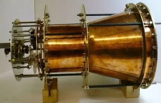

There exists a web page and a "theory" by the proponent
Suppose that an effect really exists. The main objection is momentum conservation, because the setup sounds like a variant of the bootstrap effect: a drowning man cannot pull up himself by his boodstraps.
In the site there is a FAQ the answer an the momentum conservation problem :
Q. Why does the EmDrive not contravene the conservation of momentum when it operates in free space?
A. The EmDrive cannot violate the conservation of momentum. The electromagnetic wave momentum is built up in the resonating cavity, and is transferred to the end walls upon reflection. The momentum gained by the EmDrive plus the momentum lost by the electromagnetic wave equals zero. The direction and acceleration that is measured, when the EmDrive is tested on a dynamic test rig, comply with Newtons laws and confirm that the law of conservation of momentum is satisfied.
This answer may suffice for the lab, but it is ignoring that the "electromagnetic wave momentum is built up in the resonating cavity" and could be balanced by the fixed position of the apparatus. (When running, the forward momentum is balanced by the opposite momentum of the earth).
EMdrive
In a space environment the whole apparatus has to balance the momentum. If there is thrust, (i.e. the effect does not disappear) the only explanation, imo, would be electromagnetic radiation (photons) leaving the apparatus with momentum equal and opposite to the forward momentum. It is a metallic apparatus and could very well radiate like a directional antenna . This could be checked under lab conditions.
