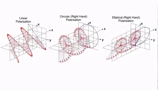

High school physics student here, so please bear with me for a moment.
I know that light waves oscillate, but I don't know how. In textbooks and diagrams they're portrayed as wavy lines traveling through space, but I don't think most light waves oscillate in perfect sine waves like that (unless they're polarized).
At first I thought they oscillated in sort of a "spring" shape, like a three-dimensional sine wave, but I later found that that's another kind of polarized light called circular polarization. What I imagine now is the wave going all over the place while retaining the same amplitude and period, like a ball bouncing along in an infinitely long cylinder, but of course I have no idea if that's actually the case.
So what do light wave oscillations look like?

If you look at one specific point in space of your light wave, the electric and the magnetic field which is perpendicular to it are both in their turn perpendicular to the direction of propagation. So, both fields lie in a plane perpendicular to the direction of propagation. Both fields are varying with time in a sinusoidal way. Different polarizations are possible. In linear polarization the electrical field and the perpendicular magnetic field always point in the same direction. They increase in magnitude over time, reach a maximum, decrease again etc. Another kind of polarization is the circular polarization, where the electrical field is again perpendicular to the direction of propagation, its magnitude is constant but the tip of the vector is describing a circle in the plane perpendicular to the direction of propagation. The magnetic field, being at any time perpendicular to the electrical field and the direction of propagation, is also describing a circle. You can also have a mix between the two polarizations where the tips of the field vectors describe ellipses. The case of an extremely 'thin' ellipse reduces to linear polarization and the the case of a extremely 'round' ellipse reducing to a circular polarization. The picture bellows shows how the three cases. Only the electrical field is shown. enter image description here

This is possibly not a full answer, but the Wikipedia article Polarisation of Light below seems to suggest to me that, because of the chance of partially polarised light occurring, there may not be a well defined answer to your question:
because the mathematical appearance of the light wave oscillations may depend on the degree of partial polarisation, which could be potentially infinite for circular polarisation.
Most common sources of visible light, including thermal (black body) radiation and fluorescence (but not lasers), produce light described as "incoherent". Radiation is produced independently by a large number of atoms or molecules whose emissions are uncorrelated and generally of random polarizations. In this case the light is said to be unpolarized. This term is somewhat inexact, since at any instant of time at one location there is a definite direction to the electric and magnetic fields, however it implies that the polarization changes so quickly in time that it will not be measured or relevant to the outcome of an experiment. A so-called depolarizer acts on a polarized beam to create one which is actually fully polarized at every point, but in which the polarization varies so rapidly across the beam that it may be ignored in the intended applications.
Light is said to be partially polarized when there is more power in one polarization mode than another. At any particular wavelength, partially polarized light can be statistically described as the superposition of a completely unpolarized component, and a completely polarized one.[10]:330 One may then describe the light in terms of the degree of polarization, and the parameters of the polarized component. That polarized component can be described in terms of a Jones vector or polarization ellipse, as is detailed above. However in order to also describe the degree of polarization, one normally employs Stokes parameters (see below) to specify a state of partial polarization.[10]:351,374–375

Light waves are polarized. They're transverse waves. And like Jac said, they can be plane polarized, circularly polarized, or elliptically polarized. But they're still polarized. Ocean waves are polarized too. And they're portrayed as wavy lines. But again, note that they move smoothly, they don't actually oscillate. If you're in the water you would go up and down and around, like the red test particles. You would oscillate, but the wave itself doesn't.
GNUFDL image by Kraaiennest, see Wikipedia
Note that the wave isn't just some hump at the water surface. It goes down deep. The wave motion gradually diminishes such that at some depth you can't detect it. In this respect the wave takes "many paths" when it goes from A to B.
Think of that as a combination of linear polarization this ↑ way and this → way.
