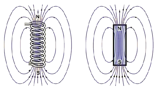

Chuck a charged particle past it and it moves in a circular fashion around the magnetic field lines. No work is done. Now wrap the wire into a number of loops until you've got a solenoid, whereupon your magnetic field is reconfigured to resemble that of a bar magnet:
Image courtesy of Rod Nave's hyperphysics
Chuck a charged particle through the middle of the solenoid, and it moves in a circular fashion around the magnetic field lines. No work is done. Now get hold of two bar magnets, and let them attract one another. When this occurs no work is done. Instead you do work on the magnets when you pull them apart. It's rather like gravity. You do work on a brick when you lift it. Gravity doesn't do work on it when it falls down. It merely converts potential energy into kinetic energy, which typically gets dissipated as heat.
