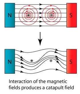

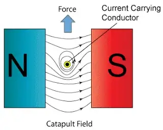

Is it possible to explain what actually causes the force on a current carrying conductor in a magnetic field. I have read that this is due to the magnetic fields 'interacting' in some way.
This diagram encapsulates the idea
Apparently the force results from the field lines wanting to 'snap back'. Is this correct? Is there a way to explain the physics behind why the concentration of field lines results in a force experienced.

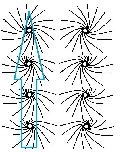

Yes. You can understand the linear and rotational forces between charged particles easily enough. The next step is to understand the rotational force on a charged particle near a current-carrying conductor. That's essentially a stationary column of metal ions and a moving column of electrons. Ever read Einstein talking about a field as a state of space? OK, see the gravitomagnetic field, which is described as "twisted space" by NASA author Tony Phillips? You can think of the electromagnetic field as something similar but a tad more intense. Only if you had motion relative to it, you might think of it as "turning space" and start talking about curl aka rot which is short for rotor. IMHO this is the key to really understanding how magnets work. The electrons all have a negative electromagnetic field, and the metal ions all have a positive electromagnetic field with the opposite chirality. If the electrons weren't moving, the opposite "twist fields" would just about cancel each other out$^*$. However the electrons are moving up the wire:
So it's like you're moving through one set of twist fields but not the other. And when you have motion relative to a twist field, you think of it as a turn field, and that's what a magnetic field is. So what you "see" is a residual turn field, a magnetic field, around the wire. An electron thrown past the wire moves in a circular fashion not because of some magical action-at-a-distance force, but because it's "a dynamical spinor in frame-dragged space".
The last step is to understand why two wires move together. For this you can think of your electron being confined in the adjacent wire. It moves upwards, and it moves in a circular fashion. This rotation means the residual turn field looks like a twist field, and since the rotations are counter-rotations to the left and right, you're again in a situation where counter-rotating vortices attract. There's a net linear attraction between the two wires. For the catapult, bend one of the wires into a loop to make a primitive solenoid, then into multiple loops for a better solenoid, which is akin to a bar magnet. Then bend it into a horseshoe shape and put the other wire between the poles like this:
