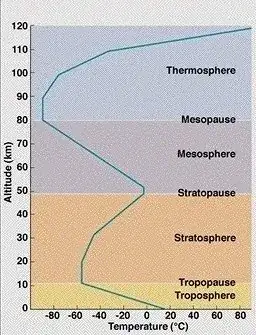

One answer is that mountains on Earth aren't all that tall. An impossibly tall mountain would see temperatures vary with altitude as depicted below.
(source: weather-climate.org.uk)
Tall as it is, even Mount Everest doesn't extend into the stratosphere. This is a question about the lowest layer of the atmosphere, the troposphere. Temperature in the troposphere generally (but not always) decreases with altitude because of four key factors:

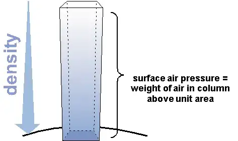

Because at higher altitudes there is less air to pressurize the air below it, the pressure drops as you go higher. If you look at this image, you can visualize this.
Air column
Credit to Indiana University for the visual.
