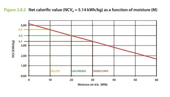

The chart below from Figure 2.8.2 on page 25 in the report provides one useful result.
The red line represent kWh/kg plotted against moisture content.
At high moisture contents (60%) about 1.6 kWh/kg is available.
For almost perfectly dry wood about 5 kWh/kg is available.
For intermediate states they identify
Wood chips - 3.4 kWh/kg Log woods - 4.0 3.4 kWh/kg
Pellets - 4.6 kWh/kg
These need to be reduced by the density when converting kWh/kg to kWh/litre
or to kWh per can of coke sized piece of wood. They provide a wide range of density values for different wood types and situations, with my density = 0.6 being close enough to usual to be useful.
