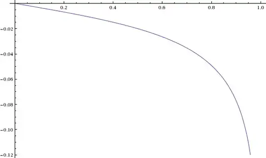

A graph of this force as a function of $\frac{r}{R}$ and $0 < \epsilon < 1$ would look roughly like this:
Graph of force function
In particular, it's negative, so the force is inward, and it gets larger as you approach the edge of the sphere. If $\epsilon > 0$, the force would be outward instead of inward, but other than being reflected over the x-axis the graph would be qualitatively similar.
