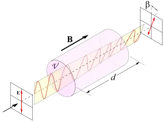

Do external forces affect light?
Yes. See for example Faraday rotation:
enter image description here GNUFDL image by Dr Bob, see Wikipedia
