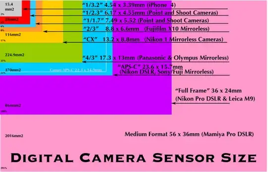

Now the size of the pixels can usually be derived from the sensor type. It is not quite enough to know you have a "12 Mpix" camera, as sensors come in (many) different sizes. Typically the best cameras have the largest sensors (and large lenses). To complicate matters further, some camera manufacturers will quote the focal length of the lens in "equivalent for 35 mm" (especially for super zoom cameras with "1200 mm" telephoto capability). But that is going a bit off topic perhaps. See https://mattsassamatt.files.wordpress.com/2011/09/sensor-size7.png for a chart (somewhat out of date) of different sensor sizes, from which you can calculate the parameter $p$ I used above.
Let me know if you have enough information here.
