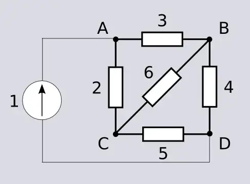

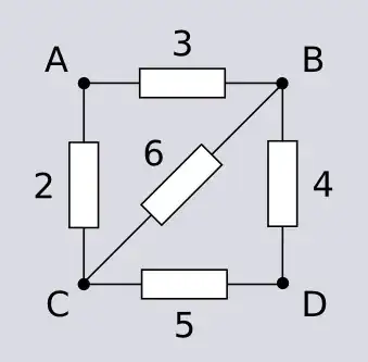

Let's suppose we have the following circuit:
and we want the resistance between the nodes (vertices) $A$ and $D$. Connecting a unit current source between them and applying the KCL we get:
$({\rm A})\quad -I_{AB}-I_{AC}+1=0$
$({\rm B})\quad I_{AB}-I_{BC}-I_{BD}=0$
$({\rm C})\quad I_{AC}+I_{BC}-I_{CD}=0$
$({\rm D})\quad I_{BD}+I_{CD}-1=0$
If we express the currents in terms of the node potentials we get the following system of equations:
$({\rm A})\quad -\frac{1}{3}(V_A-V_B)-\frac{1}{2}(V_A-V_C)=-1$
$({\rm B})\quad \frac{1}{3}(V_A-V_B)-\frac{1}{6}(V_B-V_C)-\frac{1}{4}(V_B-V_D)=0$
$({\rm C})\quad \frac{1}{2}(V_A-V_C)+\frac{1}{6}(V_B-V_C)-\frac{1}{5}(V_C-V_D)=0$
$({\rm D})\quad \frac{1}{4}(V_B-V_D)+\frac{1}{5}(V_C-V_D)=1$
Arbitrarily setting $V_C$ to zero and reordering:
$({\rm A})\quad (-\frac{1}{3}-\frac{1}{2})V_A+\frac{1}{3}V_B =-1$
$({\rm B})\quad \frac{1}{3}V_A+(-\frac{1}{3}-\frac{1}{6}-\frac{1}{4})V_B+\frac{1}{4}V_D=0$
$({\rm C})\quad \frac{1}{2} V_A+\frac{1}{6}V_B+\frac{1}{5}V_D=0$
$({\rm D})\quad \frac{1}{4}V_B+(-\frac{1}{4}-\frac{1}{5})V_D=1$
The system has 3 unknowns and 4 equations, but it's not overdetermined because each equation is equivalent to the sum of the other three. Throwing away one of the equations and solving the system we get the following node potentials:
$V_A = \frac{46}{43}$
$V_B = -\frac{14}{43}$
$V_D = -\frac{310}{129}$
As the unit current is being injected at the node $A$, the resistance will be given by $V_A-V_D$:
$R_{AD}=\frac{V_A-V_D}{1} = \frac{46}{43} + \frac{310}{129} = \frac{448}{129} \approx 3.47$
