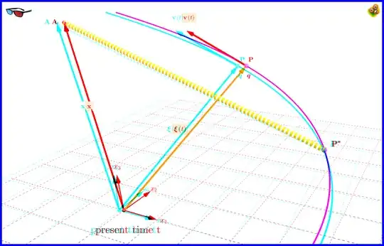

3D IMAGE FOR RETARDED POSITION

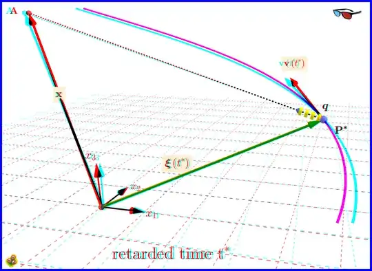

3D IMAGE FOR PRESENT POSITION
