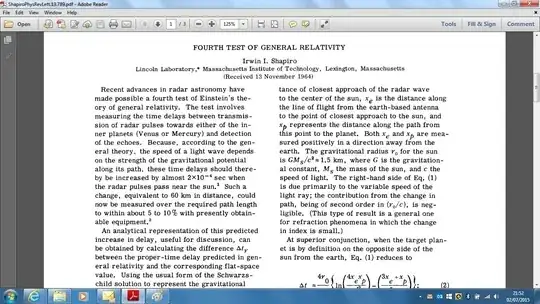

Like iharob and JohnnyMo1 said, the light goes straight. But something else happens to it. See this screenshot of Irwin Shapiro's seminal paper:
See where he said the speed of light depends on gravitational potential? The light goes straight, but it also goes slower. Also see Professor Ned Wright's Deflection and Delay of Light, where you can read this: "In a very real sense, the delay experienced by light passing a massive object is responsible for the deflection of the light".
