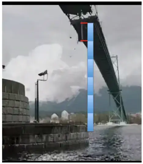

We need to know how high the bridge is. It turns out that this scene was filmed at Lion's Gate Bridge in Vancouver. This has a clearance height of 61 m. That's roughly what I would have estimated based on this picture (screen shot from the YouTube clip at 1:11, with blocks added by me to show it's about 6 buses high. A typical bus is about 10 m long, so it all makes sense):
Now the actual drop takes from 1:10 to 1:20 in the clip - that would suggest there is some "temporal dilation" going on. Normally, dropping 60 m would take 3.50 s; but in the film it takes 10. This is a clue that normal laws of physics have been suspended for the scene.
