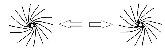

Note how the resulting "spinor" is reminiscent of vector fields? Now imagine you have two of them, with no initial relative motion. How are they going to move? Remember this: co-rotating vortices repel, counter-rotating vortices attract. They're going to move like this, linearly apart:
The linear "electric" force E between them is given by Coulomb's law, see Wikipedia where you can read this: "an electric field is a vector field that associates to each point in space the Coulomb force experienced by a test charge". But note that there is no actual electric field present, merely a linear force resulting from the interaction of two electromagnetic fields. These fields can also cause rotational force, because if you sling one spinor past the other, they don't just repel linearly, they go round one another too, something like this:
Now you can also see rotational "magnetic" force B, and you can perhaps appreciate why we talk of rot which is short for rotor. But note that the spinors have to have some initial motion relative to each other for this, and not just linearly towards each other or away from each other. Hence your two electrons only move linearly apart. Their motion relative to you doesn't change their motion relative to each other. They still move linearly apart even though you're passing them at some relativistic speed. Or they're passing you at some relativistic speed. And there is no electric field, just electric force resulting from $F_{\mu\nu}$ field interactions, so the energy associated with this is the integral of the force x distance. Then you chuck in the Lorentz factor for the relativistic motion with respect to you. What your professor said sounds right to me.
