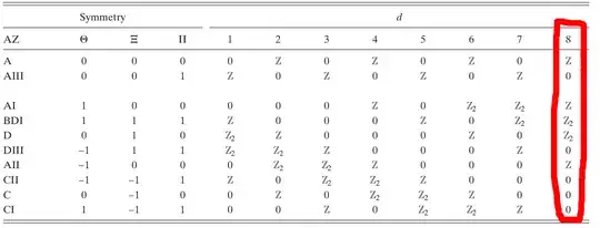

The periodic table of topological insulators and superconductors suggests that there can be topological non-trivial phases in zero dimension in non-interacting system with certain symmetries. A 0D system can be thought as a single atom, a quantum dot, or any system with discrete energy levels (no bands, no Brillouin zone).
Are there physical 0D systems which are topologically non trivial, at least theoretically? How one defines in this case the topological invariant, and what is its physical meaning?
Due to Bott periodicity, dimension $d=0$ has the same symmetry classification as $d=8$.
