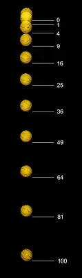

Look at the stroboscopic photograph. Is the ball "falling up" or falling down? The answer is surely we don't know!
A motion picture of this sort of sequence of the event could be run backward & would inevitably be impossible for the viewer to detect any violation of Newton's laws. A time-reversal changes both $t,v \to -t,-v$ leaving the acceleration unchanged . Thus any conclusion about forces that we reach as a result of watching a dynamical process in reverse sequence are identical with what we would conclude from the process itself. After all, attractions don't turn into repulsions or any of that sort.
