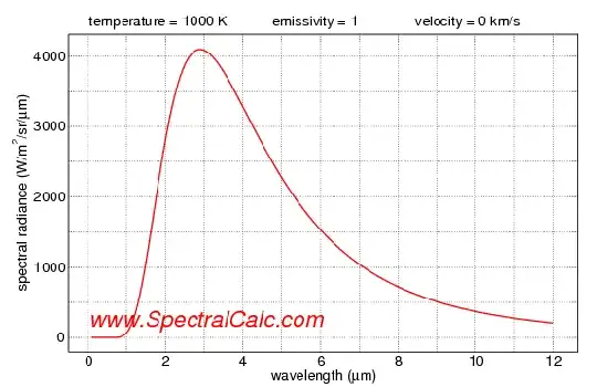

I don't know how hot campfires get, but let's take 1000K as a nice round number. The Planck distribution for 1000K looks like:
Camp fire
(Calculated, as the logo suggests, using this web site.)

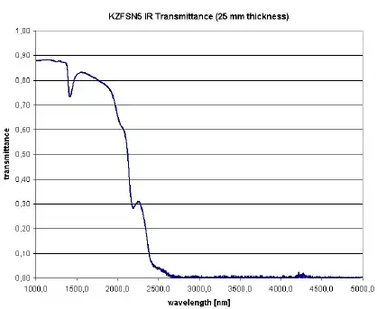

In my answer to Can a glass window protect from heat radiation? I post this graph showing the transmission of glass in the IR region:
Transmission
And this shows the transmission falls rapidly for wavelengths above 2 $\mu$m. Looking again at the distribution for 1000K most of the energy is at wavelengths above 2 $\mu$m, so while the lens will be able to focus some of the radiation from the campfire most of the energy will be lost to absorption in the lens.
Focussing the radiation from the Sun is effective because the radiation from the Sun peaks in the visible wavelengths and the majority of the radiation makes it through the lens. In principle focussing radiation from a campfire would work as well, but you'd need the lens to be made of some material that did not absorb IR radiation.
