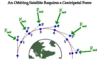

We should remember (or learn now) that momentum only works in a straight line. Gravity forces your flying object to follow the same course that it would on earth.
The green arrows are gravity. The blue lines are momentum. They add to form a curved line. The same line you are following, the bird is following, and the worm is following.
