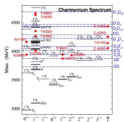

3.Exotic hadrons as in figure below
which exchange pion at low energies (couple of GeV scale) and can form a new bound state of multi-quarks as a $DD$ molecule. $D$ meson is one of the lightest meson which is very unstable check pdg list, indeed. It's mean life time about ~$10^{-15} s$.
Above these thresholds, there are some expected exotic hadrons which do not contribute quark model.
Big experiments such as LCHb, CMS at LHC, are trying to solve this puzzle. And so far, they observed X(3872), Z(4430), Y(4140) which are candidates of exotic hadrons. They did not fit into the quark model because they have unexpected narrow width and also unlikely branching ratios . These new particles are expected to have a non-quark form such as multi-quark exotic hadrons. The analysis of these particles still ongoing.
