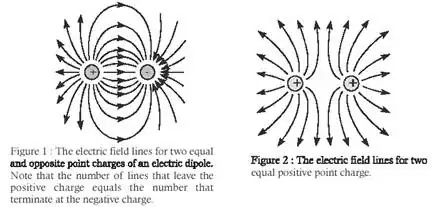

When you put two charges at a distance, they deform the -- otherwise flat -- electromagnetic (EM) potential field. Depending on whether the two charges have the same sign or not, the EM field will be deformed differently.
Electric field lines for two charges with opposite sign on the left and same sign on the right
Quantitatively, the deformation is measured by a local change in the EM field, and considering the static setup we consider, this change is solely measured by the electric field $\mathbf{E} \equiv -\mathbf{\nabla} \phi$ generated by this system of charges.
Deforming the EM field costs some energy that is stored as a curvature term of a electrostatic potential sheet if you will.

The total energy is thus expressed as the sum of the individual contributions coming from each particles plus a correction due to the fact that, when the charges are close enough, the EM field deformations generated by one charge will be affected by the deformations created by the other.
As we can see, the sign of this corrective term is that of the product $q_1 q_2$ and is negative whenever the charges dont have the same sign.
The interpretation that comes out of it is that when the charges have opposite sign, each charge acts as a deformation "sink" for the other charge deformations of opposite sign; that is the deformations generated by one particle are weakened by the deformations generated by the other. This deformation weakening effect is all the more important as the charges get closer and closer until they eventually overlap and yield (in principle) a zero deformation field. Since the universe seems to prefer low energy states, charges with opposite signs attract one another as a consequence.
The opposite is true of charges with the same sign whereby the deformations generated by one charge is simply enhanced by the presence of the other charge. Thus the EM field has more "curvature" energy to store than what it would have had if the charges had been accounted separately (or if they were infinitely far from one another). Since Nature again prefers low energy states, this implies that charges with the same sign will repel each other.
