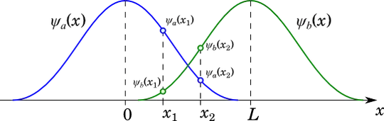

The term $U_\text{ex}$ is not zero only if the particles are close enough to each other and their wave functions overlap (see picture below). In classical limit when distance $L$ is big the overlapping is zero and $U_S=U_A=U$
Let's assume that $\psi_a$ and $\psi_b$ are non-negative everywhere anv $V$ acts as Coulomb interaction (i.e. positive and decreases when the distance increases). Then $U$ and $U_\text{ex}$ are positive and energy of symmetric coordinate state (opposite spines) is higher than energy of antisymmetric coordinate state (similar spines). If the average positions of the particles are fixed the exchange interaction will put the spins same direction.
