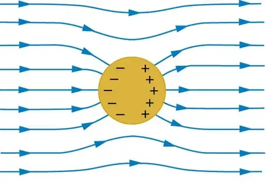

There is one property of electric lines of forces which states that:
Electric field lines start and end at 90 degree at the surface of the conductor.
But why is that so? Is there any proof for this statement or is it observed by any experiment?

The reason is the same as why the electric field inside a conductor is zero: if it isn't zero, the free electrons undergo a force and move (rearrange) until they don't feel a net force any more (sum of all forces equals zero). If the electrons don't feel a force, the electric field must be zero.
At the surface of a conductor, the free electrons feel a force perpendicular to the surface, but can't go out of the conductor. If there were a component parallel to the surface, the force on the electrons also has a parallel component and the electrons would move until that component is zero.
The surface of the conductor has constant electrostatic potential $V$ and the electric field is proportional to the gradient of the potential: $\nabla V$. By definition the gradient of a scalar quantity is always perpendicular to the level curves (surfaces).
