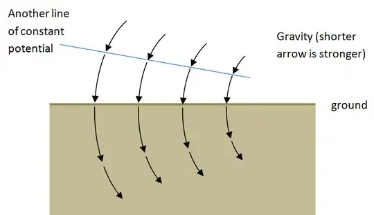

Even though you were wrong, you nailed the critical question at the heart of the necessary understanding. Bold is my emphasis:
Modelling this planet at my head then anywhere that effective gravity increases in strength is effectively lower potential energy "down" from anywhere that it doesn't. I would expect this to cause the planet to deform and reshape so that the effective gravitation was equal at all points on the surface.
A planet will deform and reshape so that the gravitational potential along its surface is constant. This is not the same thing as gravitational field, and you can follow this back to the physics 101 rigor of separating the notions of fields and potentials. On large scales, you should be able to walk along the planet's surface without doing any work. Our brains want to extrapolate this statement to also imply that gravity is constant over the surface. Actually, it only dictates the direction of gravity is constant, and not its strength. In a pseudo 2D world, the basic idea works as follows:
curved arrows gravity
(EDIT: I have updated the image to be more accurate. The initial model had arrows going straight down, but this was problematic because it creates non-conservative fields, and I don't want to imply that is the case here. In the updated picture, the blue line could be reasonably imagined to be equipotential although my art skills are not great.)
In this weird world, you could take a train over to you neighbor's house and find the gravity to be noticeably different. This story does not violate the necessary physical criteria.
You might notice other strange things. For instance, if planes flew at an altitude where the air's density was a certain value, then we would find that they fly higher in the equatorial regions than in the polar regions. In fact, this effect is intensified further by the shape of the rotational false field. Since Mesklin rotates so fast, the height of a space elevator from the equator might only be a few 100 km or so. If you flew a plane high enough, the equations tell us you might make it all the way into space! In actuality, this tells us something different. If this were possible, the air would escape and leak out into space and Mesklin would be left as an airless world, even at its poles.
However, on the basic gravitational physics, the book had it right. The surface gravity varies as you travel along it. This does not mean that you walk up a slope to get to different regions with different values of gravity (that's what I hope the illustration helps with). Instead of walking "up" or "down" to a new gravity field, you walk "sideways" into it.
