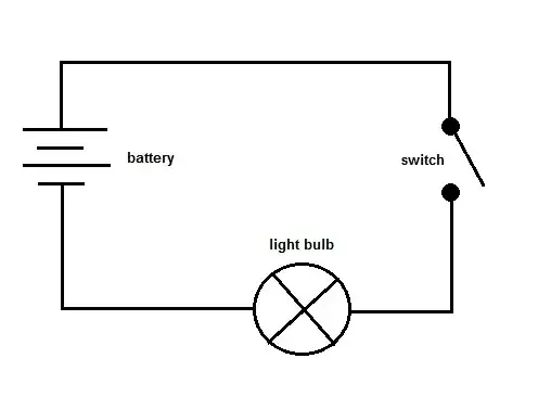

simple circuit
This is a simple circuit with a battery a switch and a light bulb.
The battery has the energy in chemical form, i.e. there are atoms and molecules separated into ions that generate a voltage drop, (an electric field ) accross the switch. No current flows as long as the switch is open, and no energy is transfered.
Once the switch is closed a current develops in the wires, electrons in the conduction band move through the wires from the positive to the negative pole through the light bulb. The electrons have an average drift velocity, carrying kinetic energy. In the wire itself they do not lose energy. In the resistance of the lamp they lose energy transferring it to the molecules of the resistor. The way electrons lose energy when decelerated is through photons, in the case of the light bulb infrared photons which make the lamp incandescent and then excite the electrons of the molecules of the resistor to high levels, enough to start deexciting in visible light photon transitions.

See my description above . It is nor really friction, as friction is a macroscopic effect. It is electromagnetic interactions.
