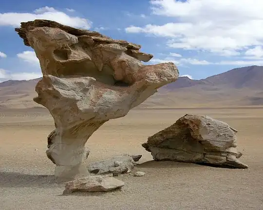

Things actually do get destroyed by what those air molecules pick up and throw around.
Take look at this example rock
[image from here: http://en.wikipedia.org/wiki/File:Arbol_de_Piedra.jpg ]
Just like their bigger sized brothers, it's the load of those mini-torpedos that brings the destruction.

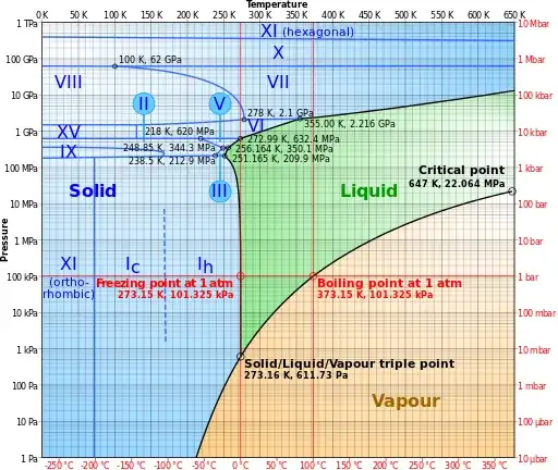

Exactly how well water molecules stick together is determined by temperature and pressure. In some cases, water does go directly from solid to gas. If the pressure is high, water remains liquid even at temperatures of hundreds of degrees. This happens on the ocean floor at volcanic hydrothermal vents.
This phase diagram shows behavior at different regions.
phase diagram
