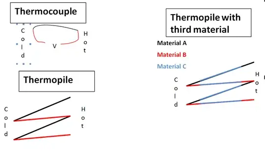

  3. I have now drawn a diagram showing a single thermocouple, a thermopile per the answer below, and my question, which is whether you can introduce a third material connecting the other two. I'm guessing you can, and that whatever its electropotential, since it's symmetric it should have no effect on the voltage of the thermopile other than its resistance. diagrams of thermopiles

  1. How do you make a series circuit with lots of thermocouples? Surely this must be done, yet when I draw a diagram, I can't come up with a way that doesn't look like two identical thermocouples are simply operating in opposing directions.
A series connection of thermocouples is called a "thermopile". It's connected like this: enter image description here
  1. Suppose you take two materials with an electropotential: Cobalt and Lithium. If you could make two junctions between them, one a cold, and one a hot, could you take a third material (copper) and use it to connect the two junctions? Does that ruin the thermoelectric effect?
Not sure what you're asking. You want to connect wires made of lithium, cobalt, and copper in parallel?

I am writing this answer for several reasons. First, the current accepted answer is wrong. Second, that answer does not even answer the updated question involving a 3rd material. Third, it does not answer question 2.
1) The asker already answered his own question thanks to endolith's diagram even though the asker correctly pointed out that endolith is wrong in that "heat does flow well from one end to the other". No! A good thermoelectric material has a low thermal conductivity! This is a very active research topic nowadays: scientists are trying to figure out a lot of ways to decrease the lattice contribution to the thermal conductivity. What's more, endolith claims that generally one has surfaces of constant temperature in which the thermoelectric material is sandwhiched, and that these temperatures do not change. This is not true. In general one has a given heat source (could be the Sun, a motor, a Joule effect in wire) that heats a surface (the one of the hot part of the thermogenerator or thermopile for instance), but that temperature will of course be affected by the heat transfer toward the cold part. In other words, the choice of the thermoelectric materials will have an impact on the temperature difference! So a more correct remark would be "Heat flows from one end to the other" or "Heat flows from one end to the other although good thermoelectric materials have low thermal conductivity which impacts (negatively) on this heat flow".
2) Usually material A and B are made of n-type and p-type semiconductors, respectively. So the electrons are moving toward a different end, according to the material A or B, as you point out. In p-type materials, the charge carriers are holes which will gather at the cold side. In an n-type semiconductor, the electrons (they are the charge carriers) gather at the cold end. The result is that the voltage due to the Seebeck effect in each material adds up. So, to answer your question, yes, materials A and B are doing opposite thing and the reason is that they have opposite charge carriers.
