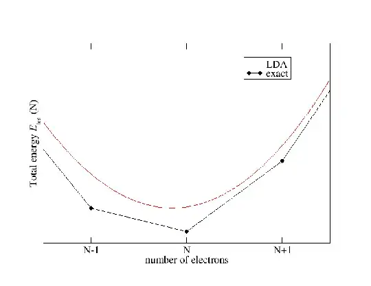

  3. Let us assume fractional particle numbers and take a closer look at the energy and its dependence on the number of electrons. It is known that this dependence qualitatively behaves as sketched in the following figure: totalEnegryVsParticleNumber The exact xc functional connects the total energies for integer particle numbers by straight lines and features derivative discontinuities $\Delta^{xc}$ at integer particle numbers. The local density approximation (LDA) on the other hand shows a smooth behavior.
Based on the equation for the fundamental band gap given above we can derive another expression for the exact xc functional: $$E_g = \lim_{\eta \rightarrow 0^+} \left\lbrace \left.\frac{\delta E[n]}{\delta n(\boldsymbol{r})}\right|_{N+\eta} - \left.\frac{\delta E[n]}{\delta n(\boldsymbol{r})}\right|_{N-\eta} \right\rbrace$$ where $n(\boldsymbol{r})$ is the density.
By plugging in Janak's theorem $\partial E / \partial n_i = \epsilon_i$ and the derivative discontinuity one ends up with $$E_g = \epsilon_{N+1} - \epsilon_{N} + \Delta_N^{xc}$$ where $\epsilon_i$ denotes the energy of i-th electron state in the Kohn-Sham system.
Detailed derivations of this result are provided in, e.g., J. P. Perdew, M. Levy: Physical Content of the Exact Kohn-Sham Orbital Energies: Band Gaps and Derivative Discontinuities, Phys. Rev. Lett. 51, 1884 (1983) or E. Engel, R. M. Dreizler: Density Functional Theory - An Advanced Course, Springer (2011).
The essence of this result is that even with the exact xc functional the Kohn-Sham band structure does not provide the fundamental band gap of the real interacting-electron system as it does not include the finite and positive derivative discontinuity.
