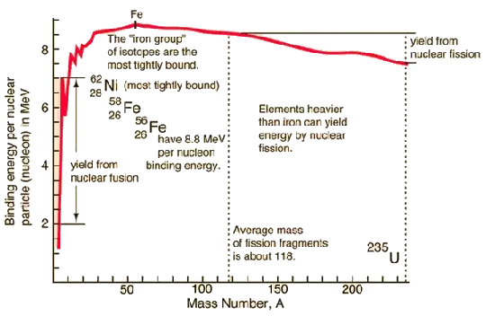

At the level of nucleons and elementary particles in general, special relativity holds. When we look at the periodic table of elements and count the number of neutrons and protons in a nucleus, adding up their masses ends up in a higher number than the mass of that nucleus. This is due to special relativity that binds the nucleons into a nucleus at the creation of that element, by the nuclear force , into bound energy levels. This is the nuclear binding energy curve:
What does a decay of a nucleus mean? It means that the binding energy level holding the nucleons together is unstable, has a lifetime for decay into smaller nuclei: the energy balance of before and after, adding masses, leaves energy over which goes to kinetic energy of the fragments and is observed.
No energy is added because it already exists from the creation of the nucleus.
