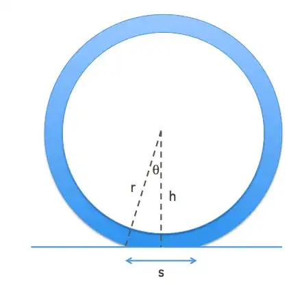

Just to illustrate, I will take a road ("racing") bike as an example - using rough numbers so you see how the math is done. The tire might be just 20 mm wide, and inflated to 8 bar. Adding weight to the tire will barely increase the pressure inside, but it will increase the contact area - mostly the length of the contact patch. The tire will look a little bit "flat":
We can compute the area of the patch, and the degree of flattening, as a function of the contact angle $\theta$ in the above diagram:
$$\sin\theta = \frac{s}{2r}$$
The degree of flattening is given by
$$f = r - h = r(1-\cos\theta)$$
For example, a 100 kg person might load each wheels with 50 kg (500 N). At a pressure of 8 bar (8 kgf / cm2), you need a contact area of about 50/8~6 cm2 to support that much weight; this means the patch would be 3 cm long (it is 2 cm wide). For a wheel that is 70 cm diameter, that subtends an angle of about 2.5 degrees, and gives a "flattening" of less than a mm. This is why a road bike rolls so smoothly over a flat surface - the less distortion, the less friction.
Using the same equations to determine a "maximum" load, let's assume we can tolerate a distortion of 5 mm; we can now work backwards:
$$f = 5 mm\\ \cos\theta = 1 - \frac{5}{350}\\ \theta \approx 10°\\ s = 2r\sin\theta \approx 120 mm$$
With the contact patch 12 cm long, it has an area of 2*12=24 cm2 and can support a force of 24*8~200 kg
