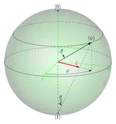

The $\frac{\theta}{2}$ can be seen on the picture given in my answer below. The red vector $\xi$ is the key point.
Once one writes the pure qubits as $$\Psi=\cos\frac{\theta}{2} \lvert 0\rangle + e^{i\varphi}\sin\frac{\theta}{2} \lvert 1\rangle \qquad (\star),$$ it is obvious that the spherical coordinates provide a one-one correspondence (a homeomorphism) between a pure qubit and a point on the 2D-sphere (the Riemann sphere, or Bloch sphere in this context). But I want to show that this homeomorphism is not artificial.

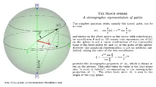

Homeomorphism with the Riemann sphere
It is obvious that the expression $(\star)$ provides an homeomorphism between the space of pure qubits and the Riemann sphere with the help of spherical polar coordinates. Obviously this homeomorphism is not linear; for example it is clear that $\ket{1} \neq -\ket{0}$ while this relation can be seen on the representations of $\ket{1}$ and $\ket{0}$ on the Riemann sphere. And it is clear that the linear combination $$ \Psi=\cos\frac{\theta}{2} \lvert 0\rangle + e^{i\varphi}\sin\frac{\theta}{2} \lvert 1\rangle $$ does not occur on the 3D Euclidean representation.
Nevertheless, this homeomorphism is not an artifical one. In the sequel, let us carefully distinguish between $\Psi$ and its representation (the $\Psi$ shown on the sphere).
It is well known that the Riemann sphere $\mathbb{S}^2$ is a representation (is homeomorphic to) the space $\bar{\mathbb{C}}$ of complex numbers "plus a point at infinity" through the stereographic projection. The stereographic projection of the representation of $\Psi$ in the $(xy)$-plane is the vector $$ \xi = \tan\frac{\theta}{2} e^{i\varphi}, $$ shown in red on the figure below.
Interpreting the $(xy)$-plane as the space of complex numbers, note that $\xi$ actually lies in $\bar{\mathbb{C}}$ because $|1\rangle$ at the Southern pole is sent to the point at infinity (whereas $\ket{0}$ is sent to the origine of the plane). Denote by $\textit{Stereo1}$ this usual stereographic projection: $$ \textit{Stereo1}\colon \mathbb{S}^2 \to \bar{\mathbb{C}}, $$ which sends the representation of $\Psi$ to the red vector $\xi$.
The point is the following one. As said before, the space of qubits is the complex projective space $\mathbb{C}\mathbb{P}^1$. And this one is known to be homeomorphic to the Riemann sphere too. This homeomorphism is called the stereographic projection too: $$ \textit{Stereo2}\colon \mathbb{C}\mathbb{P}^1 \text{(the space of pure qubits)} \to \bar{\mathbb{C}}, $$ and it is given by $$ \textit{Stereo2}(\Psi) = \frac{v_1}{v_0} = \frac{e^{i\varphi}\sin \frac{\theta}{2}}{\cos\frac{\theta}{2}}= \tan\frac{\theta}{2} e^{i\varphi} = \xi. $$
This is why I said the homeomorphism provided by spherical polar coordinates is not an artifical one: it is a natural homeomorphism because of the relation $$ \textit{Stereo1}(\text{representation of $\Psi$}) = \textit{Stereo2}(\Psi), $$ that is to say $$ \text{representation of $\Psi$} = {\textit{Stereo1}}^{-1} \bigl(\textit{Stereo2}(\Psi)\bigr). $$
