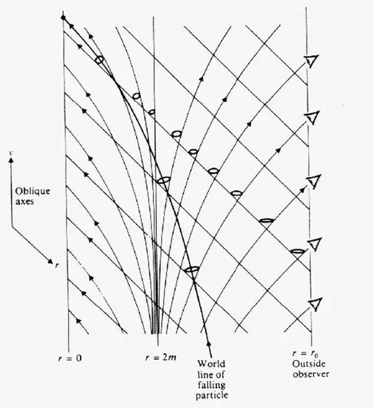

When people talk about things taking an infinite time to reach the horizon, they aren't talking about the falling particle's own proper time, but rather about the coordinate time in some coordinate system like Schwarzschild coordinates. But even in these coordinates, you can show that the particle's own proper time approaches some finite value T in the limit as coordinate time goes to infinity. It's possible to construct other coordinate systems where the same particle crosses the horizon in finite coordinate time, and these coordinates will agree that the particle's own proper time reaches T at the moment of the crossing. One example is ingoing Eddington-Finkelstein coordinates, graphed below in a diagram from this page (the event horizon is the vertical line which has the label r=2m at the bottom):

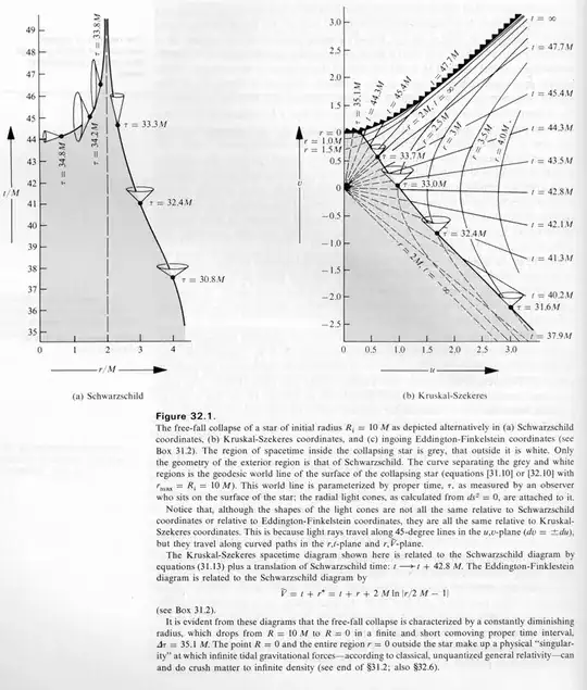

Another example is Kruskal-Szekeres coordinates; shown below is a diagram from the textbook Gravitation by Misner/Thorne/Wheeler, showing the surface of a collapsing star (the boundary of the gray region) graphed in both Schwarzschild coordinates (which has the weird property that inside the horizon, the collapsing surface is actually moving backwards in time relative to the time coordinate) and Kruskal-Szekers coordinates (where the surface crosses the horizon, the dotted line marked r=2M, at a finite coordinate time and then continues moving forward in coordinate time until reaching the singularity, whose coordinate position is marked by the black sawtooth hyperbola):
Note that the Kruskal-Szekeres diagram also shows what curves of constant Schwarzschild position coordinate (the hyperbolas labeled r=2.5M, r=3M etc.) and constant Schwarzschild time coordinate (the straight lines labeled t=35.1M, t=44.3M, t=45.4M etc.) look like when transformed into Kruskal-Szekeres coordinates.

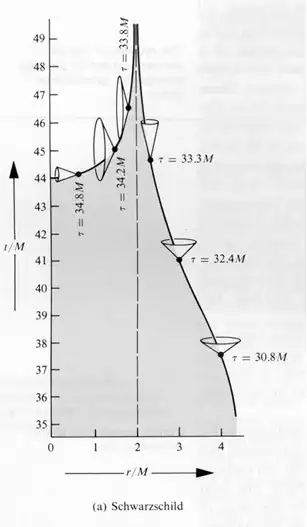

This ought to say depth of potential rather than strength of field, and the author originally referred to Wheeler and Weinberg until I queried it with Weinberg, but no matter. The important point is that there are two interpretations of GR. One leads to a black hole akin to Oppenheimer's original frozen star. The other leads to the black hole as its usually described, with a point singularity in the middle. But see where the author talks about the infalling clock reaching future infinity in finite proper time? I think that can't be right because it hasn't happened yet, and because it goes to the end of time and back. Then like Susskind's elephant, it's is in two places at once. You can kind of see this on this picture cropped from figure 32.1 of Misner/Thorne/Wheeler. Note that the plot is truncated vertically, and that the infalling body is at two locations horizontally.
