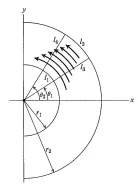

To finish let me mention that a vanishing curl (even for a position only dependent force) does not implies, in general, that the force is conservative. Those things are equivalent only when the space is simply connected. When this is not the case, the Stokes and Green theorems fail and zero curl does not imply zero circulation. The classic example is the two dimensional force $\vec F(x,y)=\frac{-y\hat i+x\hat j}{x^2+y^2}$, which has vanishing curl and circulation $2\pi$ around a unit circle centerd at origin. If this vector field is meant to be a flow velocity field it clearly means the fluid is rotating around the origin. However it gets slower as we go away from the origin. Imagine an infinitesimal closed path, $l_1+l_2+l_3+l_4$, in polar coordinates do not containing the origin, as shown in the figure. We have zero "work" over $l_3$ and $l_4$ and mutually canceling "work" over $l_1$ and $l_2$. The longer path over $l_2$ compensate the slower flow. enter image description here
