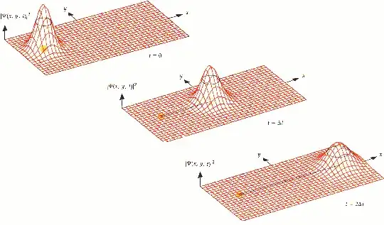

A.) When you want to stay in your hairy ball analogy, then it would best to think about this ball getting bigger and more soft. So when you have your ball at the beginning and draw a sphere around the center where the ball is hard, then this sphere you draw gets bigger over time and the ball inside the sphere becomes more soft. When you wait long enough the ball becomes very large and very soft everywhere and the center is hardly any harder than the outer layers. If you view it this way then you can call it dispersion.
Below is an image how dispersion can be depicted. The black circle would then be the sphere in your ball while the probability amplitude would correspond to the hardness. The circle (sphere) becomes bigger while the amplitude (hardness) becomes less over time.
The next thing is that the dispersion is proportional to the time elapsed, so even if the wavepacket doesn't move initially the wavepacket spreads out. And no, it's not the electron which explodes: it's the wavepacket which "explodes" in the sense that it spreads out in space. This means that a free particle becomes delocalized: since the wavepacket spreads out so does the probability of finding the electron at some place.
