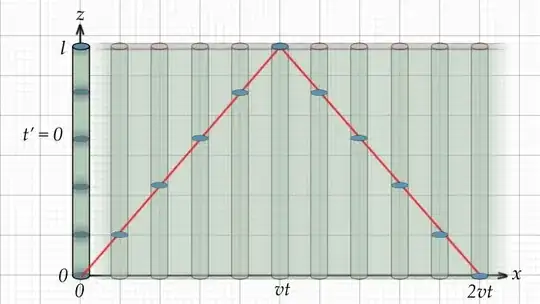

After some searching, I found a very simple way to do so.
The blue disks shows show light traversing up a rod. If the rod were stationary then the light would reach the top in ct where t starts at t' = 0. However, with the horizontal motion of the rods, the light takes a diagonal path, indicated by the red line. By the Pythagorean Theorem, we get $$d^2 = l^2 + (vt)^2$$ (d being the distance of the first half of the red line)
Since l = ct, we get $$d^2 = c^2t^2 + v^2t^2$$
Since d = ct', we get $$c^2t'^2 = c^2t^2 + v^2t^2$$
Solving for t', we get $$t' = \dfrac{t}{\sqrt{1-\dfrac{v^2}{c^2}}}$$
Divding by t, we get $$\frac{t'}{t} = \dfrac{1}{\sqrt{1-\dfrac{v^2}{c^2}}}$$
Which is the Lorentz Factor
