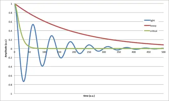

How such an oscillator responds when you give it a displacement and then let it go depends on the kind of damping - see this graph:
In particular, the critically damped oscillator converges to its equilibrium position as fast as possible - which is why it's preferable for things like a compass.
