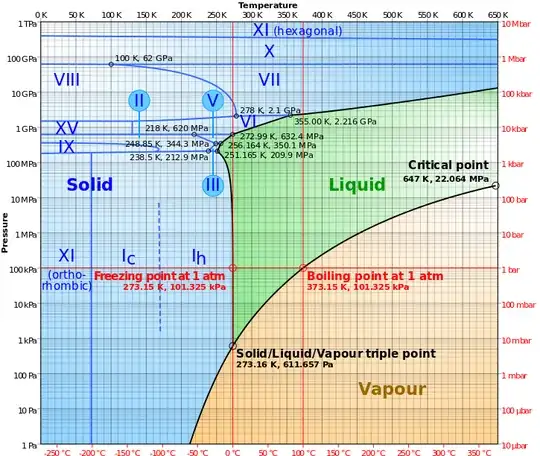

Unfortunately, you can not make a bubble with water and soap in a high vacuum. enter image description here
as you can see in this phase diagram of pure water, if the pressure is lower than 611.657 Pa, liquid water will not exist no matter what the temperature is. Maybe you should try some other material, but not H2O.
