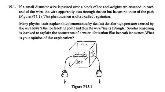

This problem, coincidentally, is literally a textbook case. Tester and Modell presents it as the problem 15-1: Problem 15-1

To solve Problem 15.1 from the Tester/Modell book, we need to understand the phenomenon of regelation, which involves a wire cutting through ice under the influence of attached weights without leaving a trace. This problem is often explained by the pressure-melting point relationship of ice.
Explanation and Analysis
Regelation refers to the process where ice melts under pressure and refreezes when the pressure is reduced. This phenomenon can be explained using the principles of thermodynamics, particularly the Clausius-Clapeyron relation, which describes the phase boundary between ice and water.

Explanation of the Phenomenon
  1. Pressure Application:
    • When a wire with weights is placed over the ice, it exerts a high pressure on the ice directly beneath the wire.
    • According to the Clausius-Clapeyron relation, this high pressure lowers the melting point of the ice.
  2. Melting and Cutting:
    • The ice under the wire melts because the pressure has lowered its melting point below the current temperature.
    • The wire sinks through the melted water, continuously melting the ice beneath it as the pressure is maintained.
  3. Refreezing:
    • Once the wire has passed through, the pressure is removed, and the water refreezes back to ice because the pressure is no longer lowering the melting point.
    • This explains why the wire can cut through the ice without leaving a trace.

To calculate the weight necessary on each side of the nylon line to cut through a cube of ice, we need to determine the pressure required to lower the melting point of ice below the ambient temperature. Here are the steps to approach this problem:
