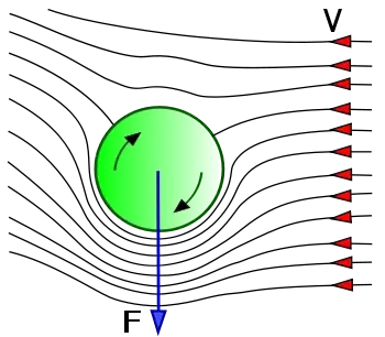

But how can this be the case? Let's consider this diagram of lift on a spinning cylinder in viscous flow:
The mechanism by which this spinning cylinder would produce lift would be the unequal viscous shear on either side (due to different relative velocities to the fluid). The air on the bottom of the cylinder would be accelerated by viscous shear, whereas the air on the top would be retarded. This moves the downstream stagnation point (or equivalently, causes a deflected downstream wake), and the rest is Newton's third law.
But in an inviscid flow, there is no way for the airflow to be entrained by any viscous effects! Even if we accept the no-slip condition at the boundary of the cylinder, how does the air traveling at the boundary of the cylinder accelerate the air near it without relying on viscous shear?

However, we use it all the time. So what gives? It turns out that many of the effects we are interested in are viscous, but the viscous effects can be modeled various other ways. This is effectively the same type of question as Does a wing in a potential flow have lift?
Just like with a wing, we can ignore the starting problem by saying all of the initial transients and vorticity generated by viscous effects are far from the spinning cylinder. But we know circulation must be conserved, so that starting vortex that was generated by the viscous effects causes us to attach a vortex rotating in the opposite direction to the cylinder (or the wing, airfoil, etc.). This is the bound vortex that we encounter all the time in aerodynamics. It allows us to model the generation of lift around a body in an inviscid flow.
But it's really important to remember that lift does not exist without viscosity and likewise inviscid fluids do not exist! They are a mathematical construction that enables us to model phenomenon we are interested in modelling.
When we model this flow, we super-impose a vortex solution with a uniform flow solution. This gives different velocities on top and bottom and this results in different pressures and thus lift. But it only exists because we impose this vortex solution where the cylinder is. And we can do that because it is maintaining the requirement that there be zero circulation throughout the entire fluid (which includes the initial starting vortex). My very poor drawing of this for an airfoil found on my answer to why a wing has lift illustrates this:
When we solve using the potential flow equations, we essentially cut our domain along that dashed line, removing the starting vortex from the domain.
