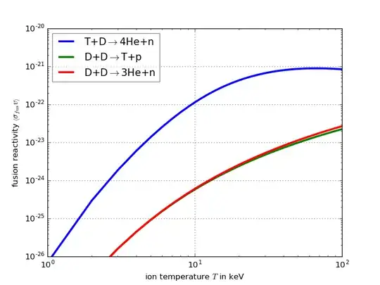

They both occur with roughly the same probability. To calculate their actual reactivity, we look up data from experiments and might get something like what is shown in the following plot.
fusion rate coefficient
As you can see, the rate coefficient of the D-D reaction is basically increasing with energy (temperature), it will asymptotically approach a very broad maximum at temperatures which are larger by an order of magnitude (sorry for not showing but I couldn't find the necessary data). For comparison, the D+T reaction is also shown and you can see why this is favored in the lab: its reactivity is larger by two orders of magnitude almost over the full range shown here.
To summarize, you don't need to actually climb up all the Coulomb wall to let the particles fuse, finite probability for fusion does occur at much lower temperatures.
