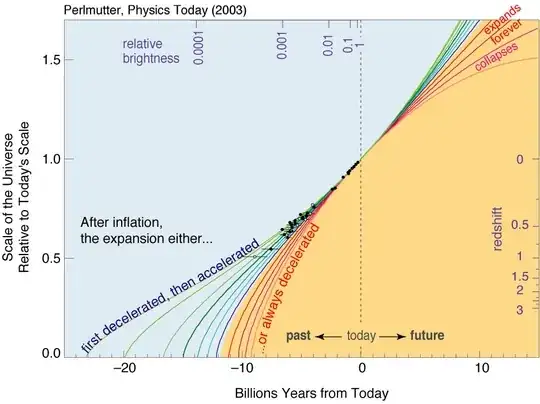

I like the following image (from Perlmutter et al. 2003) - it has been populated with more data now - but it shows the point. The curves show the scale factor of the Universe as a function of time. A uniform expansion (a universe with no dark energy or gravitating matter would just be a straight line). The gradient of this graph at any point in time tells you the value of the Hubble "constant" at that time. The Universes with dark energy have a point of inflection where the gradient stops decreasing and starts increasing - i.e. the universe decelerates for a bit and then starts to accelerate. The observations of type Ia supernovae looked far enough back that they went (just) beyond this point of inflection and were able to see the difference between the measured velocities and the velocities predicted by a purely decelerating universe. There are quite a lot more measured supernovae now populating the region around 10 billion years ago, but I can't immediately lay my hands on an updated version.
