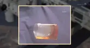

In NASA TV (see video), I saw the prototype coffee cups. They are shaped with a sharp crease, to allow liquid to ride up the groove. More advanced product would also mix waxy and wettable surfaces to keep it stuck to the inside of the cup but not crawl over the brim, except at the sip line.
https://encrypted-tbn1.gstatic.com/images?q=tbn:ANd9GcSvJFMOZpjTXVQZp6fuXyH5UXcTBH3TPBjNjsbAcEeBWegNHCYg
The pictures are hard to figure out; watch the video or read an article that shows a series of pictures and diagrams.
