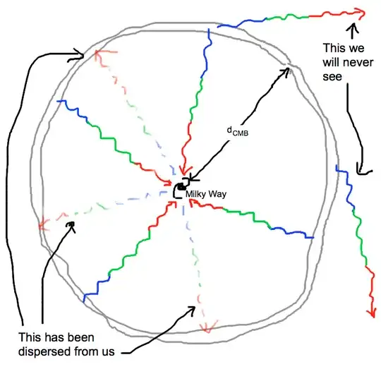

The CMB was emitted from everywhere, in all directions. The CMB emitted at the point where you are standing right now, has now been dispersed to a distance $d_\mathrm{CMB}$ equal to the distance that light can travel in the almost 13.8 billion years that have passed since it was emitted*.
(note that $d_\mathrm{CMB}$ is much larger than 13.8 billion lightyears, since the Universe has expanded since it was emitted; in fact it's roughly 46.5 billion lightyears.)
On the other hand, the CMB emitted from a distance that is now $d_\mathrm{CMB}$, is what we observe today. That means that the CMB we observed today all comes from a thin shell of the Universe in which we are centered, and which has a radius of $d_\mathrm{CMB}$.
The drawing below may help understand; in a while from now, the picture would look exactly the same, except $d_\mathrm{CMB}$ has increased so that the sphere will be larger, since by that time, photons originating from farther away will have had the time to reach us.
