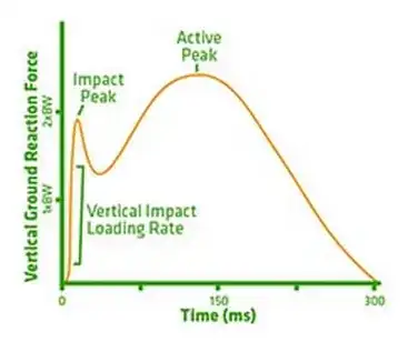

Entire books have been written on the subject of how to walk / run to minimize impact. But a nice start is this article in runner's world - which includes this diagram:
The vertical scale is multiples of body weight (BW). See the article for more detail.
