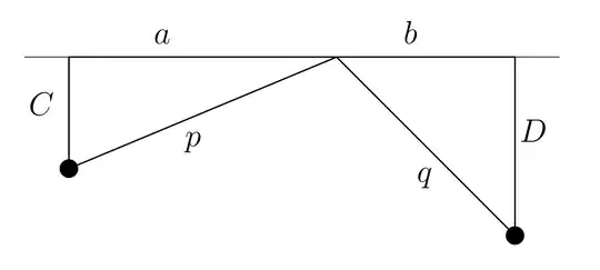

Consider the problem of minimizing the length of a piecewise straight path connecting two fixed points with a given line, as shown in Figure 1. For instance, the line could represent a river along which a single pumping station is to be built to serve two towns. The distances $C$, $D$, and $S = a + b$ are specified; the goal is to determine $a$ and/or $b$ so that $ℓ = p + q$ is minimized.
The standard solution to this problem involves expressing $a, b, p, q$, and hence $ℓ$, in terms of a single variable, typically $a$, then minimizing $ℓ$ by computing $\frac {dℓ} {da}$ and setting it equal to zero. This computation is straightforward, but involves the derivatives of square roots and some messy algebra.
Figure 1: Minimizing the combined distance p + q between two fixed points and a line
Consider instead the following solution, using differentials. First, write down what you know: $$a + b = S$$ $$a^2 + C^2 = p^2$$ $$b^2 + D^2 = q^2$$ $$p + q = ℓ$$
where $S, C, D$ are known constants. Next, take the differential of each equation: $$da + db = 0$$ $$2a\ da = 2p\ dp$$ $$2b\ db = 2q\ dq$$ $$dp + dq = dℓ$$
We are trying to minimize $ℓ$, so we set $dℓ = 0$ to obtain
$$0 = dℓ = dp + dq = \frac{a}{p} da + \frac{b}{q} db = \left ( \frac{a}{p} - \frac{b}{q} \right ) da $$
so that
$$\frac{b^2}{a^2}=\frac{q^2}{p^2}=\frac{b^2+D^2}{a^2+C^2}$$
which (since lengths must be positive) quickly yields
$$\frac{b}{a}=\frac{D}{C}$$
so that
$$a =\frac{CS}{C + D}$$ $$b =\frac{DS}{C + D}$$ and it is straightforward to verify that these values do in fact minimize $ℓ$.
