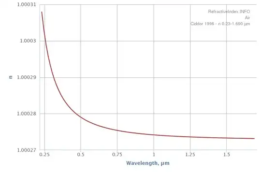

The other, somewhat unrelated concept that you ask about is the fact that the index of refraction of air is different from that of vacuum. In reality, the index of refraction of air is slightly different than vacuum, but in practice this small difference can often be neglected. Even air has some dispersion (see below), but not enough to separate the light from the sun into distinct colors like a prism.

As mentioned by others so far, the index of refraction ($n$) of air is not identically equal to 1, but is in fact $n=1.000293$. For many every day situations this small difference is negligible; however, it is possible to observe that light does in fact change speed when changing mediums from a vacuum to air.
